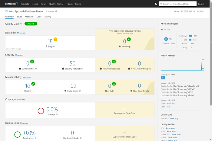

At the end, we should be able to go to localhost:9000 and see this nice generated dashboard with results of the code analysis.
